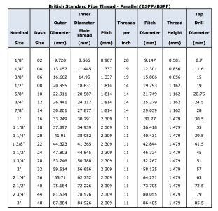

So is that 1" and 3/4" BSP?
I might have answered my own question, but still not sure what size I need 🤔☹️
Bear in mind that hose barb and thread size are not necessarily related. Truedesign certainly have a range of hose tails that step down.
Are you trying to measure the through hull thread to replace the cock or replacing everything to fit a hose size?
