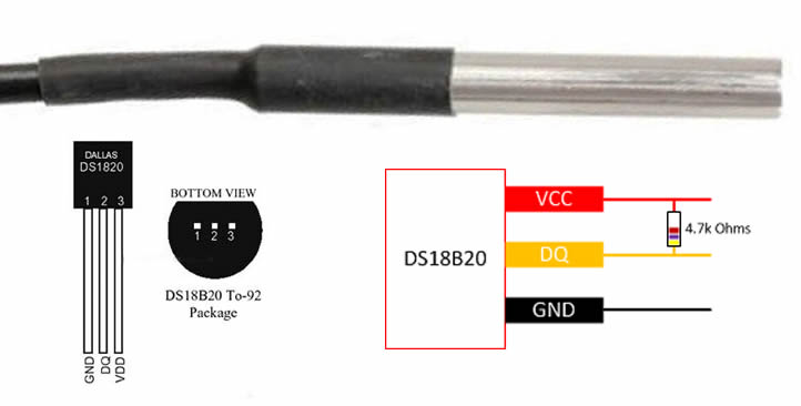

I don't really have a use for the sea temperature, and the log transducer is out of the water, so I plan to experiment with a sensor somewhere on the engine.
ds18B20 :cool:
