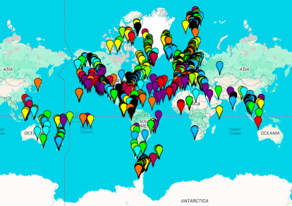

The Secchi Disk citizen science study is now in it's 7th year and I wanted to bring you an update to show how the study is progressing through sailors taking part.
The best way is by the project map and this image, taken today, clearly shows the global coverage the study is achieving.
While you cannot zoom into the map I have attached you will see that the intensity of data (as well as the coverage) is quite great in places if you visit the data map on the study's website.

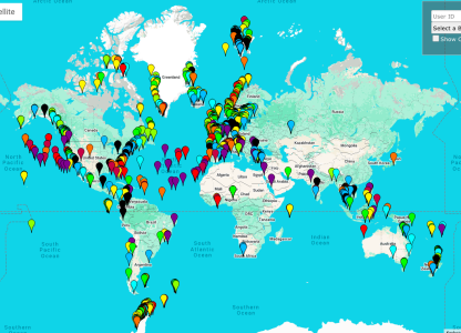

In 2025 the study enters its 13th year having begun in 2013. The data map below shows just how much the study has grown through the participation of sailors.
Originally, the study was launched to engage with sailors, divers, fishers. The study soon covered every ocean and we had pioneering data collected from places like the Northwest Passage. Now, the Secchi Disk study has been embraced by the expedition cruise industry too as a science and outreach tool and, as a result, we have the largest in-situ database of measurements from the Antarctic and Arctic regions, which will become a useful scientific resource as the data accumulates over future years. The results from the study that we have published so far in PLoS One and Nature Scientific Reports show the value of the citizen science data.

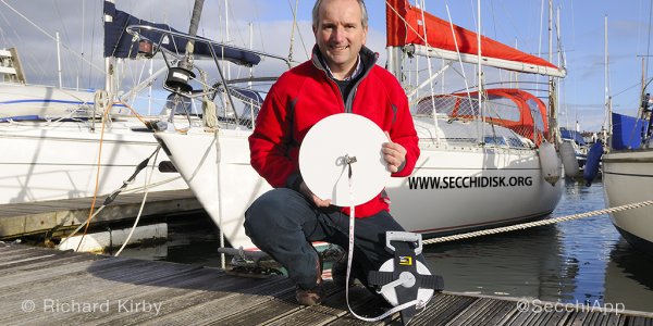

Could you do a short explanation of what is required a d how you go about taking the readings please.
It's very simple. I'll explain below and instructions are also given in the free mobile application Secchi for GPS capable smartphones/tablets (nearly all modern devices) and in fact, the app doesn't allow you to enter a Secchi depth measurement until you have read the instructions :) The app is available for both iOS and Android devices.
The following may seem long-winded. But taking a Secchi depth measurement itself takes only about 5 minutes.
Firstly, you need a Secchi Disk 'apparatus'. (We can supply (see here) in return for a donation to the charity but we strongly encourage sailors to DIY as it is so simple.)

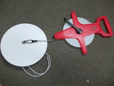

The SECCHI DISK - the DIY approach
A marine Secchi Disk is a 30 cm diameter white disk with a central hole ~M6. (If you Google 'Secchi Disk' you will find images of Secchi Disks that black and white quadrants and of a smaller size but that is the freshwater version, marine Secchi Disks are always plain white and 30 cm diameter.)
A Secchi Disk doesn’t have to be a perfect smooth-edged circle, just so long as it is plain white, 30 cm in diameter and it is as circular as you can make it, a 'good' circle.
What materials can be used?
The Secchi Disk we provide is made from 5 mm Foamex. 3 mm or 5 mm Foamex is an ideal material as it is inexpensive and can be cut easily, with a craft knife. Small pieces of Foamex can often be obtained for free from display / sign printers. Supermarkets also often have old Foamex display signs that they are happy to give away and one side is usually plain white. You can also buy Foamex from Ebay too, and some Ebay shops offer a cutting service.
Ten litre paint bucket lids are often 32 cm in diameter and are easy to trim with a craft knife or strong scissors. Paint/interior decorating shops that make up coloured paints for customers often have some spare buckets/lids.
You can also use a thin piece of marine plywood painted white, 3 mm is ideal, but note that water pressure during use will eventually delaminate the ply and deteriorate your Disk. Plywood is not the best option.
A plastic, white food preparation board is another option,
In fact, anything painted white. The only consideration is that the material should not be too buoyant.
Once you have a white Disk, drill a hole in the centre and use either a double stainless steel lifting eye bolt or more simply, just a small loop of Paracord passed through to allow a Fibreglass tape measure (or a non-stretchy rope marked in 20 cm intervals - use different colours for the 20 cm and m intervals) to be attached from one side and a 2 lb or ~ 1 kg weight from the other.
For most sailors we recommend a 50 m Fibreglass tape measure. However, if you are ocean cruising you may require a 100 m tape measure. A considerably, more expensive option that we do not supply, is to purchase a Yamayo Million Surveyors Rope MSR100 (Diameter Tapes / Surveyors Rope) spooled onto a cable tidy reel like this Cable Tidy Reel 25m Mains Hook Up Lead Wire Holder Storage Caravan Motorhome | eBay. Yamayo has distributors in various countries. The Yamayo tape is more durable than a cheap Fibreglass tape measure although it is not easy to put on the spool but, once spooled, it is easy to use. If you choose the Yamayo option mention the Secchi Disk study to Yamayo.
In most cases a 50 m tape measure will suffice. if you find you need a longer length and you only have a 50 m tape you can add a known length of rope between the tape and the Disk.
If you use a Fibreglass tape measure do not rely upon the metal attachment loop that comes with the tape as this will quickly corrode and one day your disk will descend to the depths. We double over the end and secure with a 8 mm bolt, Nylock nut and type-C washer: see the image below.
For the weight, any old lump of metal will suffice. The amount of weight you will need will depend upon the currents where you sample. A heavy link of old mooring ground chain, an old 1 kg weightlifting disk, fishing weight etc. Hang the weight underneath the disk using some Paracord.
You may also consider a short line from the tape measure to the yacht or even your wrist in case you drop the kit into the sea
