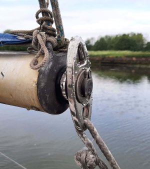

Slab reefing is simple enough. A little way aft of the leach cringle, pop rivet a deck eye on one side of the boom and a cheek block on the other, reverse the sides for the second reef. At the gooseneck, another cheek block each side to turn the line up to the luff cringle, through the cringle, and back down to the foot of the mast. On my Snapdragon, I had a clamp of stainless steel with a fold on the top to hold more blocks, then the usual turning blocks, and clutches to take the two reefing lines, the mainsheet, topping lift, kicking strap and a line to allow me to adjust the stakpak lines. Since I didn't need a winch on the mast any more, I removed it and fitted it to the coachroof to handle the mainsheet and reefing lines.
A bit like this
A bit like this
