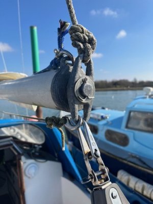

Next weekend I want to remove the mail sail then refit with a nice new stackpack but not sure where to start.
This is the aft end of the boon, do I undo this and the slide the sail out that way. If so how does this undo?
Or do I remove the boon at the mast? Again how does this undo.
Thoughts please folks

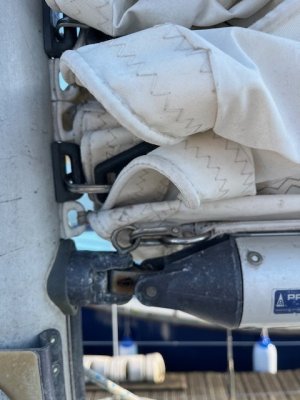

Remove slides from mast - there should be a small gap, perhaps closed off with something, to let the slides come out.
Then mainsail should slide forward out of the front of the boom. No need to remove boom.

It looks like you have a boom made by Proctor and I guess a mast likewise. Being in silver as opposed to gold this might not be original on your centaur. As to removal of mainsail as said you should find some form of gate on mast with maybe a twist knut to open the gate and allow plastic slides to be detached from mast. Normally you hoist main in light breeze like Saturday and slide the sliders out towards. Clearly also need to undo the shackle on clue end and the one shown and slide out main from track on top of boom.
As for stack pack I would speak to the sailmaker you use as to how to affix- normally it will have a way of attaching to boom-ours has track on boom each side with a plastic /fibreglass batten each side. I doubt a proctor boom is designed for a stack pack though originally unlike today’s Selden booms.
Maybe asking on the Westerly owners association website will elicit some class specific informed views on how stackpacks are attached to this boom type particularly if you have roller boom reefing with a handle on front of mast to knock out the unwary crew.

As per Ashtead for removing the main but I would add that the main slides of the boom towards the mast.

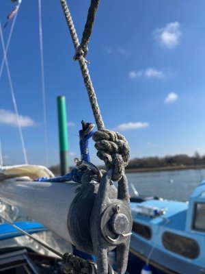

Just a point that is totally irrelevant to your question. I may be wrong, but the boom end fitting where the mainsheet attaches looks very worn in the bottom loop. This may be due to the shackle from the mainsheet constantly rubbing. I would suggest disconnecting the mainsheet & the topping lift ( which looks on its last legs) Then rotating the fitting. The mainsheet will then be fastened to virgin metal rather than a thinning piece of aluminium. The topping lift will not wear it in the same way, as can be seen from the picture, so you may get a few more years from that fitting.

On most of the booms I've seen, the slot is open at the forward end, and closed at the aft, which would preclude taking the sail off that way. It's also easier to do everything at the mast end, because it stays put, while the aft end will be wobbly at best.

All good advice above. I would go further with the boom e d fitting and throw it away. It's old and tired and will let you down. Bolt or rivet a couple of deck eyes top and bottom, or get an eye which will slide into the track.
Or just replace it with the stainless version which is a direct replacement and comes with new bushes as well
