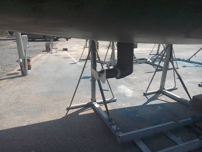

Both the international and Hempel products have their own primers. Aerosol application. Photo shows drive and hub with Hempel and prop blades painted with Velox
