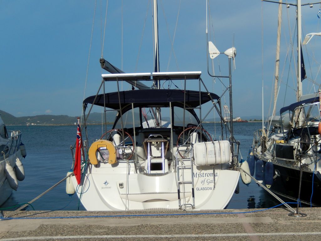

I had a similar problem and looking around with plenty of time didn't help. e.g. Guy in Cleopatra took ages to get back with a quote. No pictures, drawings or spec. just a price. A friend had already agreed to have him build an arch and it was fitted the day before launching but took months of chasing up.
I gave up and built my own from stock parts in Preveza Chandlery. They don't understand metric vs. imperial and just said different suppliers made slightly different sizes. I had to return quite a few parts and rummage for metric, still have a few imperial bits.
My arch was a little tricky for a variety of reasons.
1) Existing wind-gen designed to hinge across stern for maint. work
2) Forward pushpit section is very short
3) Bimini support hinges and moves backwards (and up then down) when stored (part of all over enclosure)
4) Bimini support arms need to thread past other supports and backstays when raising/lowering
This made the design a little more complex. I built 2 aft ladder supports and 2 side supports to an oblong frame (all in 25mm tubing). Seems to work well for 2x100W panels and also supports passarel in harbour.
Cost was under 500 euro (a simpler version would have been 350 euro) and it looks OK (but not a thing of beauty)). Still to test the folding aspect when I need to hinge it backwards to lower Wind-gen.
Picture pre-wiring tidy up.
