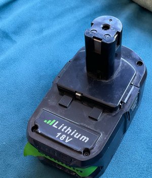

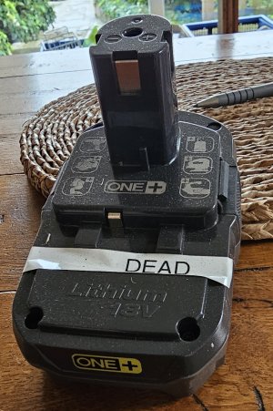

One of my Ryobi Lithium battery packs has failed. It no longer charges.
Has anyone replaced the batteries?
These are expensive units, so I'm thinking of having go at repairing it.
