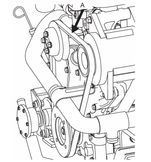

Secondly according to the diagrams in the owners manual the alternator drive belt also drives the freshwater coolant pump. ( the raw water pump is driven by a second belt)
The no charge warning light could easily be missed bur eventually, if the coolant pump is not being driven, the coolant high temperature warning would be triggered and the audible alarm should then sound.
Attached the schematic of the warning lights ( #8 is the "no charge" warning light, #5, #6 and #7 are the low oil pressure, high coolant temperature, and water in sail drive warning lights #4 is the audible alarm and #41 are the diodes which drive the audible alarm ) and a diagram of the alternator/coolant pump drive belt layout
( when fitting the new belt a strong thumb pressure at point A should deflect the belt by 8 to 10 mm)
