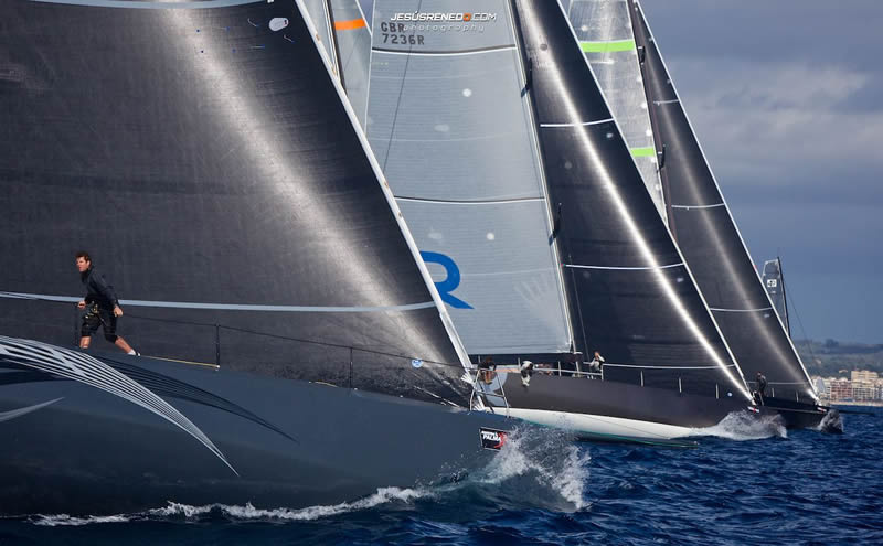

That is not a pretty boat in my book.
Interesting. I love a steeply raked stem and narrow beam. What is it that you don't like about it?
I like plumb bows on gaffers, but not the modern yacht version.
Not sure why you want a yacht to look mean? :)
Pete
Nor am I! But I can't explain why I fancy one girl and not another either. Fact is I do though.
I like the look of overhanging, spoon bows, with Charles Nicholson having a particularly good eye for a shapely bow.
But there's something about the bow wave of a plumb bow that looks so purposeful. The way the water curves upwards. Very slice-y.
