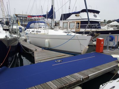

a. In my shop I have one low bench with a 2'x3' piece of tin screwed down. Soldering and hot knife work. No fire worries if I leave a hot tool.
b. I have an 18" x 4' piece of tin I take to boat if there is something big. Mostly this is for cutting carpet. Any small block of scrap wood is fine for rope. Of course, a piece of lauan would do.

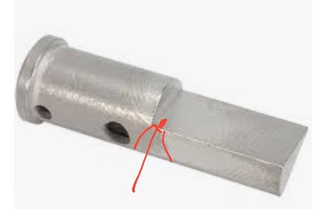

After a while it became clear that the cutting blade was actually in two parts - the part that screwed on to the heater and the blade that wedged into that. The blade eventually came loose in the housing and stopped working so well, but that was after quite a lot of use.
