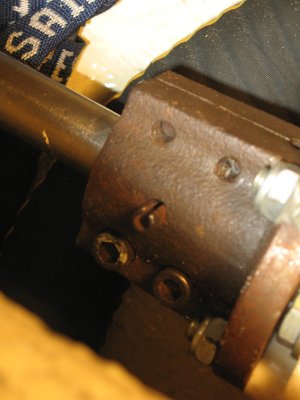

I need some informed guidance on selection and use of 'roll pins/coiled spring pins' used to hold a prop shaft to the gearbox.
When I swopped 'old-for-new' engine, I removed an old pin, then later replaced with another new one. That didn't go as well as I'd hoped.... for I knew nothing of how that ought to be done.
The replacement pin protrudes by almost half an inch. It clearly hasn't seated adequately/fully through the prop shaft and now I need to do the job properly - starting with removal.
'Tight-as-possible' mole grips have failed to budge it. I'll need to tap it out, and access is severely restricted.
I've recently learned that the hole through the prop shaft ought to be 'off-centre'....
I haven't found anything directly relevant on Youtube. Any input on A: removal, and B: replacement with a right-sized pin.... will be most welcome.
It's a roll pin; you batter them in with a hammer. Ideally/normally it's a through hole so you use a pin punch to follow it through for removal, also using topical application of a hammer. If the hole is slightly off-axis and if it's assembled back-to-front and the pin inserted then it may well end up stuck neither in nor out. Marking the clamp/coupling sections and the relative position of the prop shaft with tippex or similar helps reassembly and avoids back-to-front misery.
Go the opp side & drill a much bigger hole through until you get to the end of the roll pin. ( bigger hole less likely to snap in offset hole with care). The hole should not be miles out, so with a bit of luck it will locate on the hole the other end. Then knock it out from the other side with a drift. Then drill the big hole right through & insert a large roll pin or small bolt

The rollpin drilling does not have to be off centre, but it helps when reinserting a pin because it is obvious if you are 180 degrees out. I would never, on a boat propshaft, use a hammer. Make yourself a clamp for inserting and removing.

On a previous boat I did the calculations. 50HP diesel on a 25mm shaft with a 5mm diameter roll-pin through the centre and i still had a 4:1 safety factor. Worked perfectly for 15 years before i sold the boat. The OP's coupling is a split clamp type, which mine was not, so i was relying solely on the pin for drive.

In the photo in post#1 the collar is split and clamps onto the shaft with screws.
That is how the torque is transmitted to the shaft. By friction.
If it were transmitted by the pin, then there would be no need for a split collar; a simple plain sleeve would do and that is obviously not the case.
The pin is there simply to locate the collar on the shaft.

Despite it being a very tight 'wriggle' and actually painful, I've managed to make a much closer and more detailed inspection, from both sides. Here's what I've found.
The drilled holes in the two-part coupling clamp are aligned centrally at 180 degrees, The hole through the propshaft is eccentric i.e. it is NOT through the centre.
Consequently, the slotted spring pin runs through the hole in one part of the coupling clamp and through the hole in the shaft, but does not quite align with the hole in the other part of the coupling clamp, so cannot pass all the way into and through the second section of coupling clamp.
I can see this by peering down the hole.
I've tried several tools to squeeze/compress the pin, without success. It is very firmly jammed and possibly bent a little as the hole through the shaft is eccentric.
I'm now tempted to leave it. There's an implication for 'imbalance' and if vibration results, I'll consider bonding a small section of pin into the vacant hole to effect a balanced rotation.

I'd be knocking the pin out, rotating the shaft 180 relative to the clamp(I suspect the holes will then align, although it's possible the orientation is correct barring a lack of final alignment, it will be easier to tell once the pin is out) and fitting a new pin, but it's your train set.
Looking at the photo.
If you rotate the coupling 180 degrees you will see an empty hole where the pin would be, had it been driven all the way through. Is that right?
What I would try next is to :
1. Get a decent quality parallel pin punch; but narrower in diameter than the slotted pin. You want one that would pass right through the mis-aligned holes if there was no pin there.
2. Slacken the 4 clamping screws.
3. Turn the shaft so the pin hole is vertical, with the pin downwards
4. Bung the lower end of the hole.
5. Fill the hole with penetrating oil, eg PlusGas (not WD40).
6. Leave it to soak overnight.
7. Insert the pin punch in the hole so it is resting on the edge of the pin. Hold it firmly.
8. While reciting the mantra "If the bugger went in, it will come out!", knock the out the pin downwards.
