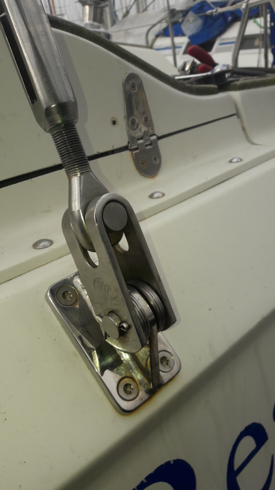

Is there any reason for having double toggles at the bottom of my backstay? It seems to me that a single toggle would give full articulation because it has two pins at right angles to each other. At the moment the bottle screw is closed and I want to get a bit more backstay tension on. There is enough adjustment in the screw to allow me to take the bottom toggle out and connect the top one direct to the chain plate.

Interesting - I have to replace my standing rigging this winter at the request of my insurance company and all my shrouds have extra toggles as the photo(apart from the forestay which is an integral Rotostay turnbuckle). one cap shroud even has two! And I assumed this was normal but after speaking to local riggers said the toggles were not necessary and just use the toggled turnbuckles which is the norm nowadays.

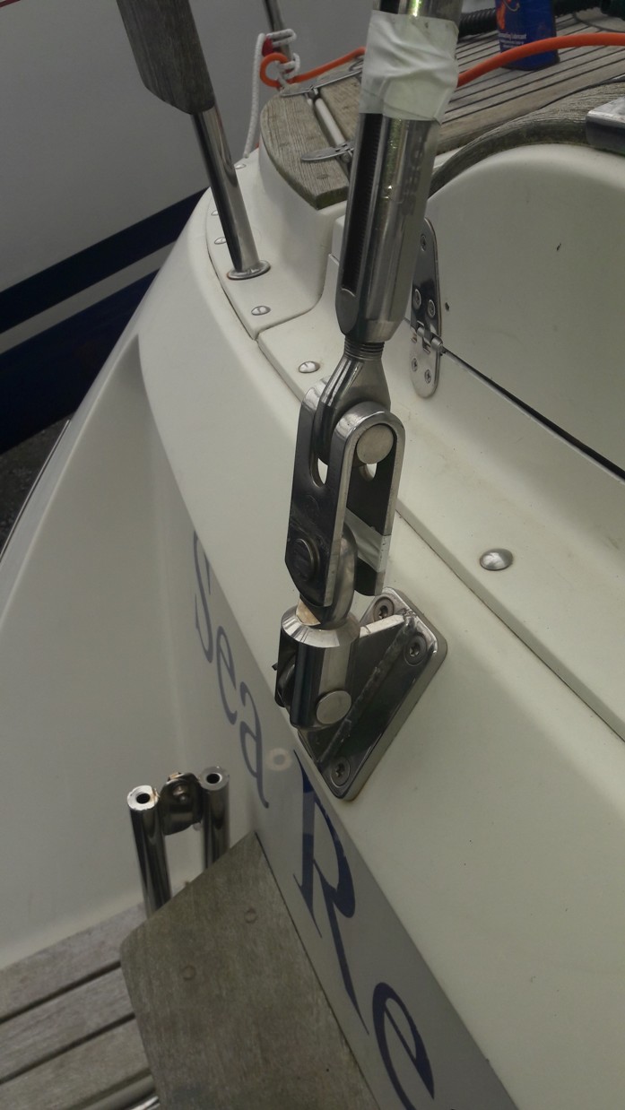

Thanks for all the replies.
I'll give it a go and if the corner of the toggle fouls the chain plate I might have to round it off a bit with the bench grinder. But from the side it looks like there should be enough room.

If the toggle allows a lot of clearance sideways to the chain plate, will you pad it with washers to keep it central? That way the stress on the pin will be more evenly spread...

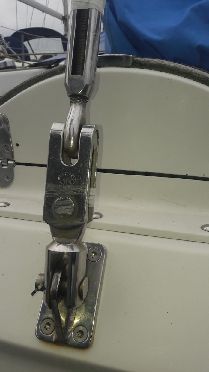

Well done! Like the spacing washers too. I guess these toggles are a throwback to when bottle screws didn't come with them built in. I certainly have quite a collection in my scrap box. They can come in handy sometimes, though. I decided a few years ago that I needed a bit more mast rake - hey presto! two toggles under the furling drum and the lee helm was gone and the genny didn't foul the guard rails any more!

If you remove a section from this arrangement how will you connect the bottle screw to the deck plate? It looks as though it was all put in to answer this question: if you want to foreshorten the stay, you will need a different connector.

I don't like the look of that. The pin is now subject to bending as well as shear. In shear it is pretty strong. But once it begins to bend?
Do not be surprised if the pin through the chainplate bends and refuses to come out.
The lods of those induced by well controlled gybe are pretty huge... Then think about an accidental slam!

Post #11 is the after picture. The before picture is in post #1.
Without the washers it was about the same as the original arrangement where the bending capacity of the pin was about the same as the break load of the wire. But the close-tolerance washers support the pin and reduce the bending moment. Shear capacity is about 150% of the breaking load of the wire. (I do structural steel and aluminium design for a living!)
It's a masthead rig on a boat with a low bow. The shock loads when a big wave breaks into the the genoa are the ones that worry me. But you're right - gybing in a blow can be pretty dramatic too.
