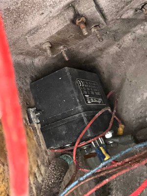

If the windlass was there before you ripped everything out the contractor (solenoids) could still be there, it will most likely be close to the windlass, follow the cables from the windlass, where do they go ?
Ok, so the windlass is wired to the control box, as are the foot switches, it makes sense that it will be up there by the windlass and I never touched anything around the windlass, so my heavy duty cables are probably running directly from the control box.
I’ll have a look tomorrow, of course both heavy cables are black so I need to fig out which one is pos and neg while I’m in there.

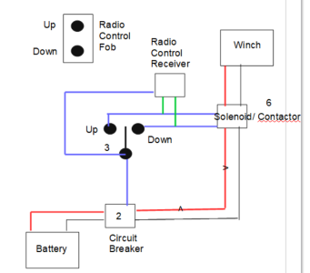

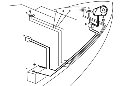

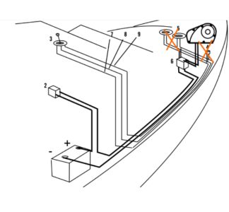

From Little Sister's diagram I have eliminated the deck switches (5) and the deck (hand controller) outlet. (4)
These are prone to failure.
These would be replaced with a radio controller fob and a receiver for a remotely operated garage door. These are a few quid on Temu.
The blue wires are low amperage "control circuit"
Thanks. Wouldn’t the neg cable go straight to the battery, not to the breaker?
Hi Steve.

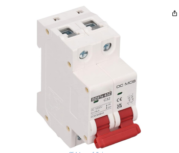

Little Sister"s diagram has a single pole circuit breaker. Quite acceptable.
I have drawn a two pole circuit breaker. Which I prefer for no real reason.
Either one will do the job.
The two pole unit will also be your on/off switch.
Gary
