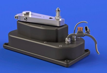

I fitted a B&G type 2 linear drive to my Beneteau oceanis 440 and there wasnt a lot of room between the quadrant and the bit you walk on (ah old age), but works a treat. I bolted a length of 100mm aluminium box section to the stbd aft cabin bulkhead and mounted the ram onto that.
noelex
2 Jul 2005
4,793
I don’t know about your specific installation but the Jefa autopilot drives often fit easily when other models cannot be accommodated.
They are fantastic drive units, but have woeful warranty support in my experience.
The Garmin Class A drive is a Jefa drive, any support issues would be dealt with by Garmin, but it's very rare for these to give any problems.
noelex
2 Jul 2005
4,793
True, Garmin rebrand the small Jefa linear drive unit.
I was thinking of the Jafa direct drive autopilot units. These use a bell crank rather than a linear drive system. This produces a compact drive unit and means they can often fit in spaces that are not suitable for most autopilot drives.
