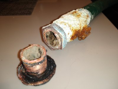

Why your insurer wants them changed
When I come out of the water, I give each of mine a good welt with a rubber mallet. I didn't bother with this one, the state of the ball valve was enough to know it needed changing ASAP. It broke when I tried to undo the nut

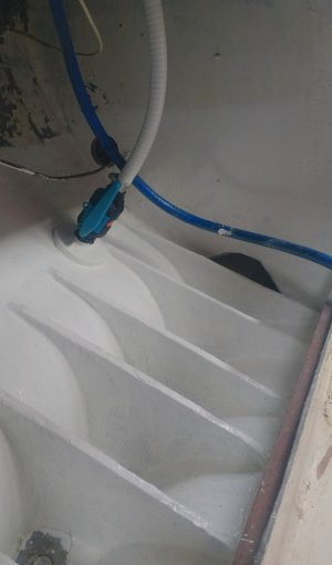

I have 6 sea cocks below the waterline and replaced 5 of them with Trudesign kit last spring. The 6th was in an awkward spot and is also bronze, so I am ok with it. My boat is 54 years old and the original through-hulls were ok, but the ones that had been replaced over the years were a bit suspect. So far nothing but praise for the Trudesign kit. It’s easy to spec and buy, and easy to fit with the right sealant. Good guides online too. But as everyone has said, I needed to be a bit inventive with the orientation as they are very bulky.
(edited as I got the numbers wrong!)

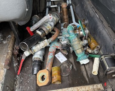

Here's some of the wreckage I removed. I'd been feeling guilty about it for a couple of seasons.

FWIW, I laminated a 10mm thick board and cut the backing pads from that, bedded on thickened epoxy because even the best plywood can rot out and where do you get a small piece from...?
