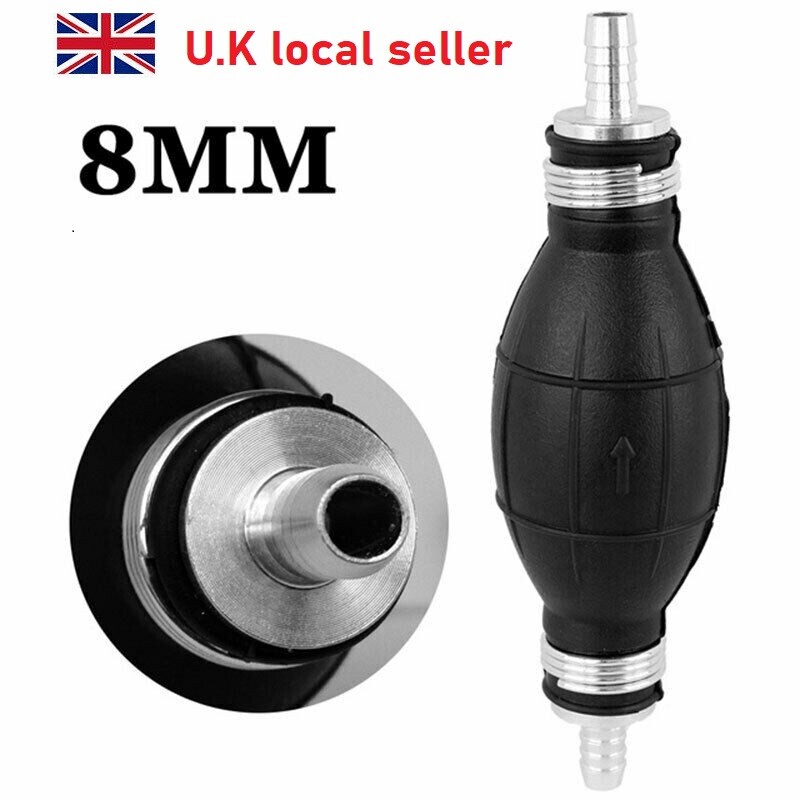

A quick search for fuel filter with primer pump came up with several, but they're all one filter, one pump. A simpler alternative for a twin filter system might be to put something like this in the line from the tank, before the Y tap.
8mm Fuel Primer Bulb Hand Pump Diesel Petrol Gas Priming Non Return Valve Car | eBay
