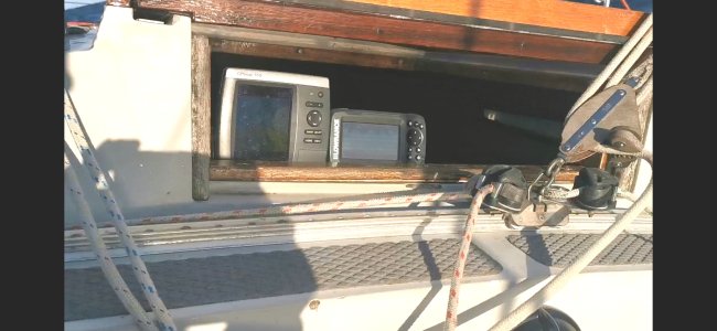

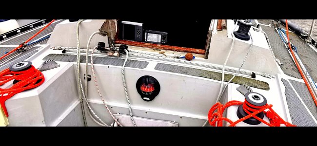

The main sheet has a car and track. The car is tired, probably 40 years old, stamped with the manufavturers name 'Tye' , which as far as I know does not exist anymore
The main track curves across the deck between port and starboard. Although not by a lot.
Is it easy to bolt a new track down to the curve.
The boat is 26ft. Any recomendations for a make and model for replacement?

Without looking at the photo I thought it was bent in a radius but it seems it's just bent over the bridge deck in which case it will be no problem. The smaller Lewmar system should be fine and you will be able to use the existing holes as the captive bolts slide along the underside of the track and will locate at you existing hole spacing.
Lewmar Mainsheet Traveller Kit
There are cheaper systems like IYE
