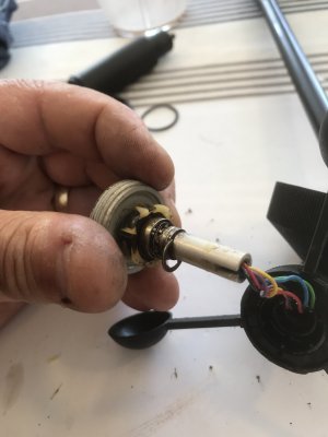

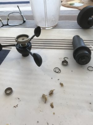

Done it!!! Bandg 283 stripped down - now to source 2 new bearing cartridges from tinternet!A3D42E94-E2BB-4396-9674-BD2EC3C06BDC.jpeg

I’ve done my 496 twice - over a period of 20 years.
Provided you can unscrew the cassette from the stem, it is easy peasy. Lots of online guides. If it breaks , you have to use epoxy and your ingenuity.
Make sure you buy SS bearing races.
imaginz
21 Aug 2018
3
I believe the bearings for the 496 / 283 are SFR2-5ZZ
1/16 allen key for spindle
