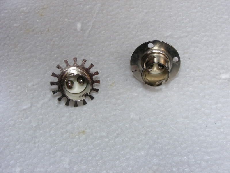

BTW my 3 sectored LED came with a special replacement holder that had to be fitted so that the 3 sectors of the LED could be lined up correctly with the three coloured sectors of the lens.

The new LED tricolour comes with the mounting plate thingy to get it lined up right. I've already lit up the bulb to work out where the sectors were, as there's no marking on it to show which is forward.

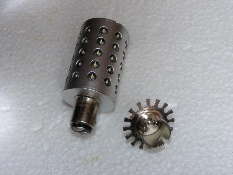

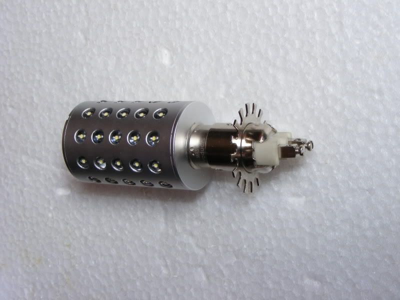

A few pictures

A few pictures
That looks the same as the one I have.
