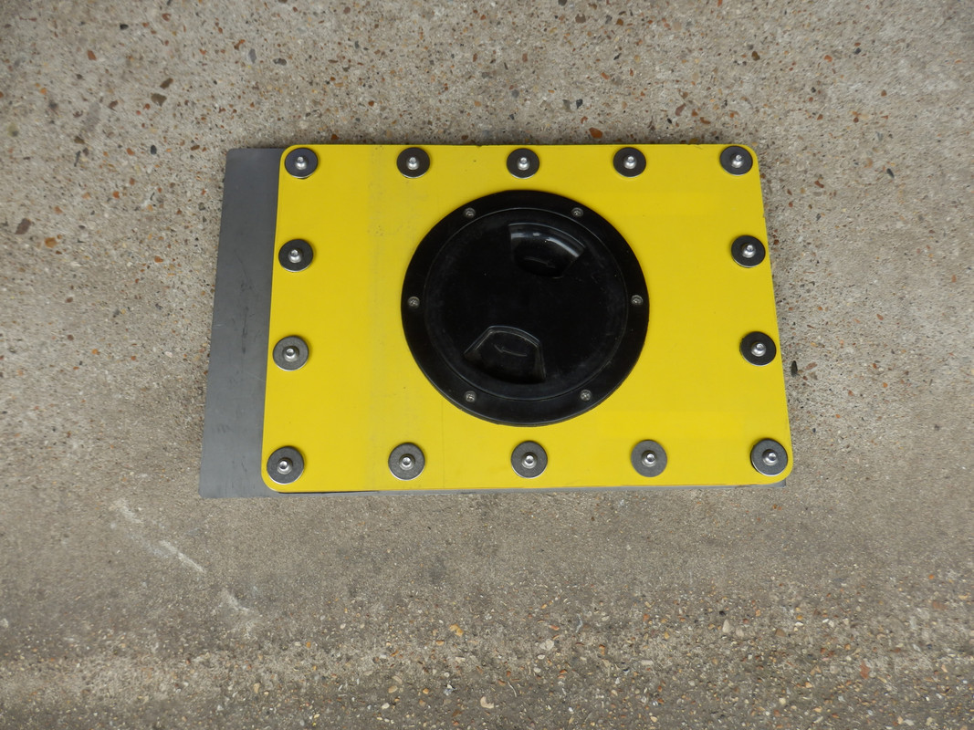

Just thought I'd update this.
I can't get to the boat yet to fit it, but I made this out of an old flat sheet of Fibreglass I had hanging around, a sheet of 1mm stainless that I cut and welded nuts to the back of, a sheet of rubber, and a spare small hatch the same as the one already fitted.
A quick check on what's going on down the hole can be done through the small hatch, but for any work that needs doing I can unscrew the panel.
Nasher
Your rectangular hatch is generally how I do my access hatches except I fit set screws in the inside frame, washers and nuts on the outside, so the gasket is held in place when fitting the top but also if any of the set screws strip then can be replaced very easy.
