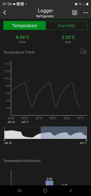

This is a graph of the refrigerator on the boat, for an overnight period, when the door wasn't opened.
You can see that it is working, but I think that the temperature range is to big. It's swinging between +2.64C and +8.95C.
I think that the ideal range should be between about +2C and plus +5C.
I can adjust the thermostat down a bit to get to +2C, but I don't think that will bring the +8C down very much.
The refrigerator is 17 years old.
It looks like the compressor is working Ok, but the thermostat is on its way out.
I can probably replace the thermostat.
I noticed that the milk was going "off" much quicker than I expected.
Any comments or am I over thinking this again?
The gap between on temp switch and off temp switch is the switch hysteresis. You need a much smaller value. 2 deg C or less. Replace the thermostat with a better spec unit or adjust it if you can or go to an electronic one where you get a display and flexible settings. Carel is a good brand, which I have fitted in my boat.

Aside from what others have said. eg. Thermostat differential etc. The compressor is obviously bringing the temp. down but the rise in temp seems unduly rapid. Maybe that needs investigating.

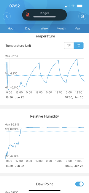

We had something that looked very similar with a new fridge setup, turns out it was the victron battery protector I had fitted inline with it that was malfunctioning/misreading the supply voltage. Removed it and all good.
Trying to avoid thread drift but that is very intuitive data from your Victron setup, can I ask (trying not to be nosey) what Victron product(s) provided this:-)

Trying to avoid thread drift but that is very intuitive data from your Victron setup, can I ask (trying not to be nosey) what Victron product(s) provided this:)
Angus
Ah, the screenshot was from the app that links with a thermometer we keep in the fridge, not a victron product, sorry for the confusion.
We had a victron battery protector inline with the fridge to prevent it draining the batteries, but found that when it should have been passing power thru it wasn’t even after checking the settings on it. What the graph appeared to show was the fridge getting cut off, it’s temperature rising until the victron decided the voltage was high enough to turn it back on, and then the temperature would begin to drop.
