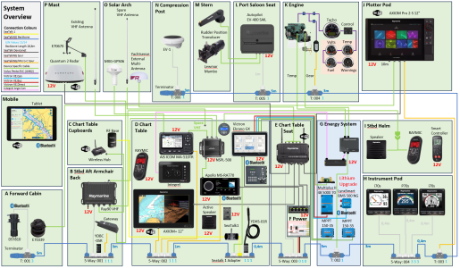

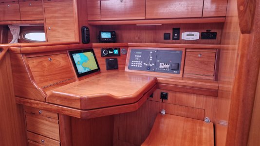

I have 2 Axiom plotters and the Quantum 2 Radar ..... very happy with the setup. Particularly like the ability to differentiate between targets closing on me and those heading away ..... watching squalls is also fascinating as it allows me to dodge the rain.
System looks like this ... replaced a complete Raymarine system from 2008.

Wow, thats some system. I haven't even seen the boat yet to find out what is hooked up to it. Im assuming the engine as is VP and there are no analog instruments apart from a rev counter. The other Linssens we looked at had a Victron charger/invertor ( Quatro 3000 IIRC). I like the idea of having the plotter remotely on the iPad (or even the Mac). One of the Brooms we looked at had it on the TV but that seemed rather clumsy unless you are just viewing

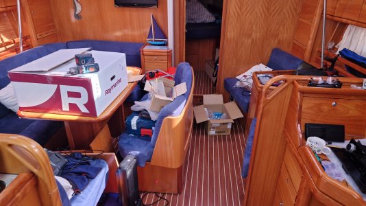

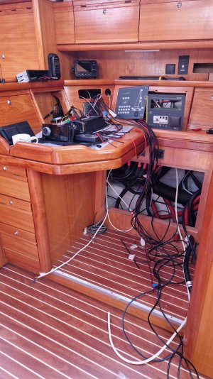

I woefully underestimated how long it would take me to fit .... the boat is 600km away and I spent the best part of last year installing it all while trying to fit in holidays as well. It's still not finished ... the Lithium system and Integrel E-Power are going in now so it will have taken me the best part of 18 Months on and off.
Looks pretty though even though most of it is hidden away ...

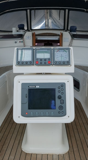

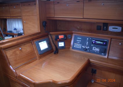

Before:
During (when I wondered if I had done the right thing ...):

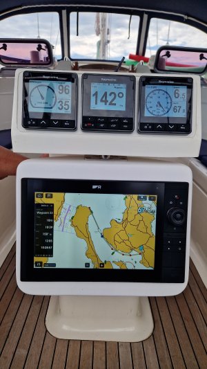

After:

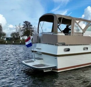

Further to this, we are thinking of putting a stern view/reversing camera on. We had one on teh Bayliner and it was a cheap. low res thing with its own tiny tablet monitor but was pretty useful. The company adverstinsg the Radar bundle have a huge range of options ranging from 50 Euro to 2500Euro. Its tempting to go for the Raymarine one but are there beter options?
Marine Electronics Discount: Comptoir Nautique
The other issue is siteing it. On the Bayliner, it was up on the radar arch but we dont have that on this boat (the radar will be on the mast at the bow). Mounting on the hood frame will be a recipe for vibration, likewise to a lesser exent on the handrails. The only real option is on the transom and it will have to be offset due to the door in the centre. Is the angle on these thinsg wide enough for this to work?
The boat is 4.3 m beam and the swim platform about a metre at its centre

Having owned two aft cabin boats of a similar design I think that you will get sufficient view astern from the helm and won’t need a camera. That said I virtually always had the rear canopy section rolled up when we went out so if you have it closed the view might not be be so good.

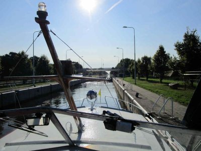

Our Hardy has no real rear view from the wheelhouse helm so I fitted a reversing camera from this outfit similar to this
It has a decent wide angle and I have the monitor at the chart table across from the helm and it helps with seeing what is behind us, particularly when on inland waters. The camera is mounted on the mast, which I see isn’t an option for you. I reckon it would be fine on the rear guardrail or perhaps at the base of the rear guardrail next to the gate or maybe on the transom under the top step - issue here is drilling a steel hull and creating a potential corrosion risk.
