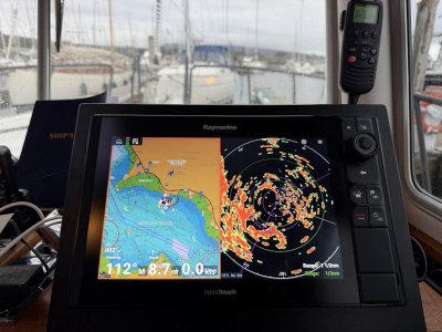

On the Day Skipper course the boat was fitted with all Raymarine, I think the radar was a Quantum, and the MFD was a Hybrid Touch
Was very easy to use and we did need to use it in the poor conditions we were out in, marking targets and getting a plot on their course to deconflict our path,
Looks like the boat we are training on has the same setup we are talking about buying :)

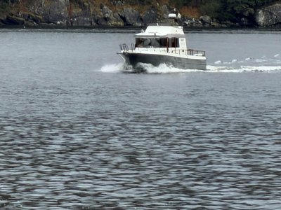

We were on Timeless, a Botnia Targa 35, twin D6 400hp on DP out drives

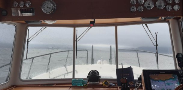

On the above pic we were doing 21-22 knots into a choppy sea on the Clyde, Storm Emma was forecast to hit later that day, so we cut our trip short only going as far as the Kyles of Bute rather than the full circumnavigation of the island we had planned the day before. Coming back we were doing 25knots with a following sea with about 1m to 1.5m waves any slower and the waves were pushing the stern around, not scary or that, just took more effort to keep her straight, at 25knots we were just overtaking the waves and I could plot a course through them. Flat out the boat can do around 40knots, very nice boat but would not like to do a week long cruise on her.
Weather was so bad that we never used the flybridge on the open water, only when manoeuvring in the marina.
