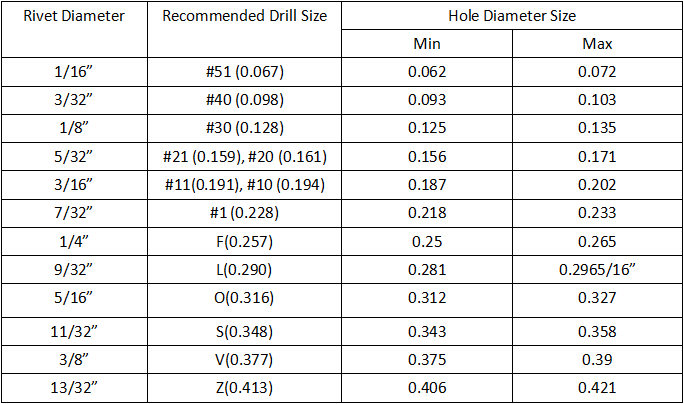

You need to drill a hole to the size recommended for the rivet to get the best result.
