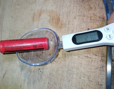

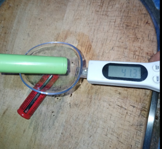

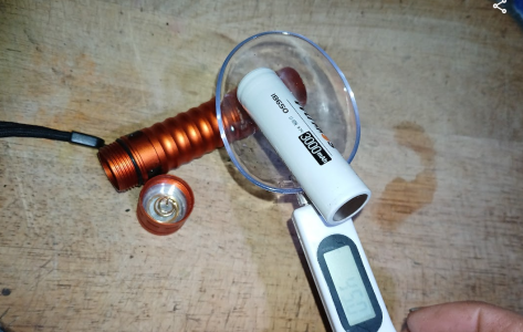

so as you mentioned it..... bought a little spoon scales for measuring tiny amounts of epoxy the other ay from the chinese shop >
And a rather lovely torch off Aliexpress, €30 😲 but got a proper 18650 in it whih would prob be at very least a fiver
can't remember where this one came from, real as well
ebay prob from a used computer pack - looks real with no BMS
and this one..... what do you think?? 🤔😁

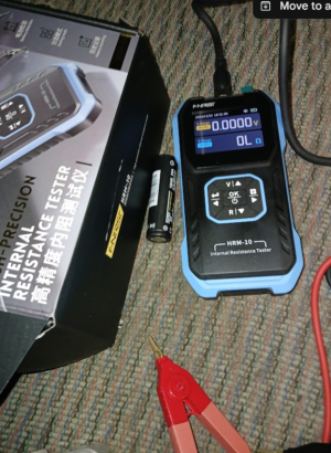

Also splashed out on a low resistance tester off ali express, ran out of hands to take pics of the tests but
Torch batt - 23.7mOhm, 3.9608v
tesla - 16.5mOhm, 4.0646v
green one 30.21mOhm, 4.0072v
fake 212.59mOhm , 2.6848v 🤔😲😁
From What is Lithium Ion Battery Internal Resistance?
Lithium-Ion Batteries​
  • Low Internal Resistance: Typically ranges between 10-50 milliohms, depending on capacity and design.
