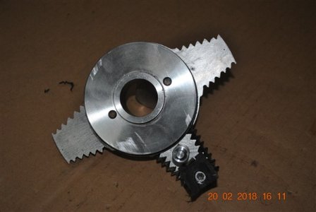

I had a two part cutter ... Ambassador Stripper ..... reckoned to be one of the best due to the tapered castellated serated cutting blades. I can say honestly that the cutting edges are sharp ! My hands were cut a few times during install.
Unfortunately - its most likely I picked up a cable of something that was too great for it to cut and the fixed guide plate on the shaft tube ripped out .. causing the most awful noise !! The 'fixed' blade was then loose to spin and bang against the other blade ...
You can see the V tab of the blade is also bent ..... as well as the studs ripped out and even snapped off.
I could drill tap new position for mount - but decided not to ... I removed the inner blade and left just the outer against the prop boss. The force of the event had pushed the blade hard up to the prop boss ...
OK - do I recc'd the Stripper - yes I do. Even though I will not be replacing mine.
Have I had any 'events' after with just one blade in place ? Yes I have and needed a dive under boat to clear the serious weed and rope that had got wound onto prop. This says to me that single blade cutters are likely a waste of money ... if that super sharp half of a stripper cannot do it - then I don't see any disc blade etc doing any better.

Similar to Refueler, when we picked up a relatively heavy rope it was too much for the fixed blade fixings of our Ambassador. The threads pulled out of the P-bracket and exactly the same a second time.
One solution is to drill and tap right through the cutless bearing, doubling (or more) the thickness of brass. Or you can purchase a collar that straps around the cutless bearing housing.
