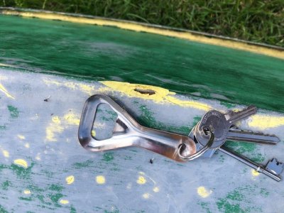

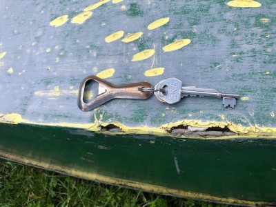

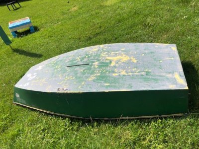

Is there a cheap and easy way to deal with the damage in the pictures? I'm thinking a bit of filler, sealant and a coat of paint, but I've never done anything like this before.

I would grind out the cracks to make them a bit bigger to accept epoxy or polyester resin mixed with a filler (epoxy is more expensive but adheres better than polyester resin and epoxy is better for repairs imho) and then I would use fibre glass tape over the holes on the edges etc and then I would sleeve (or is it sheave?) the hull in thin (like tissue paper) glass fibre and resin. There are different grades of fibre glass - chopped Matt, woven ( heavy duty) etc - the thin tissue paper like fibre glass is the lightest duty. Then clean up, prime and paint.

I'd just grind off the loose stuff and epoxy a bit of glass cloth over it. Maybe 2 or 3 layers on the damaged edges
Get some 600gm chopped strand mat, polyester layup resin, acetone, paddle rollers, brushes. Fom CFS cornwall if no one nearer.
Grind until cracks disappear, taper the edges, if the hole is big enough put a plastic bag of sand, or gaffer tape inside, patch outside, then patch inside to connect both sides with fresh layup. 3 x 200g csm and Polyester resin, dab the resin into the mat and roll out the bubbles until the mat is all wetted, do three layers at once, any more and it gets too hot. It will bridge small holes. It's best to wetout and roll the resin/mat on a sheet of scrap ply or plastic, then lift with brush and roller onto the repair, push and roll into place. Then clean brushes, rollers, hands, arms, face, hair, workbench, car, wife, kids, patio and anything else within five feet of where you did the job.

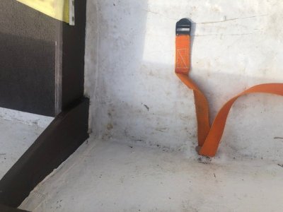

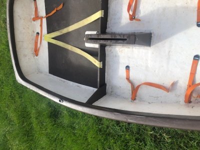

This is the inside view of where the worst damage is on the outside:

I'll have crack at repairing it as the other option is to use it as a sandpit!
