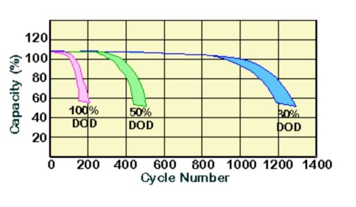

The table below suggests that using a low depth of discharge (DOD) significantly extends lead acid battery life. It also suggests that after 6 years of 180 charging cycles a year you're probably reachng the limit.
Agree about the complexity of changing to Lithium - if lead acid works for you, stick with it.
