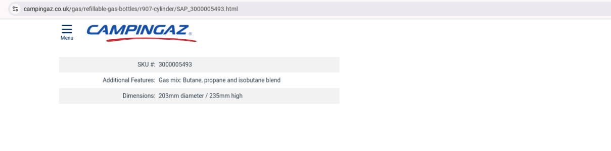

The small canisters are a mix but the 907 and 904 refills are Butane.
It's clearly stated on the campingaz.co.uk, R907 page:
"Additional Features:Gas mix: Butane, propane and isobutane blend"
I might be wrong but I believe that's been the case since they stopped refilling the bottles in the UK and started doing it in Lyon.
Momac
7 Feb 2008
7,067
UK

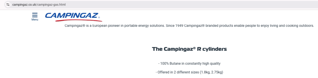

It is clearly stated on one page of the Campingaz UK website that it is 100% Butane and on another page its a Butane, propane and Isobutane blend .
I guess one of the statements could be correct but which one ?
