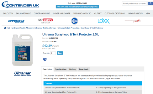

Another Brand that could be worth looking into is the Ultramar range of shampoo and protectors.. (I only discovered these after having used 'Wet n Forget' to clean black marks from the inside of a sprayhood only to find it took off all the waterproofing and turned it into a sieve. A clean and then protect with Ultramar products has worked well ever since).
Check out the Ultramar products at the Contender website...
Ultramar Textile Aftercare
And then go through to the options below..
Ultramar Fabric Protection -> Sprayhood & Tent Protector
Ultramar Fabric Cleaning -> Sprayhood & Tent Shampoo
It seems to be better priced at Contender than some other places..
