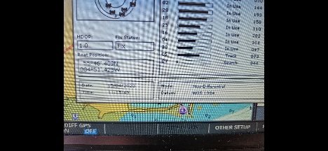

We had a similar problem last week with our Raystar 125. Try turning off the differential gps setting and turning on all the WAAS, EGNOS etc settings. Date now reading correctly.

My C90W (using the external antenna) is showing the date August 2003 (I was checking it for a separate AIS issue) but does not seem to be affected by that.
I did turn off DiffGPS and checked that the others were 'ON' (see #14) but nothing changed so I turned the Diff back on.
Does anyone know whether there a real world effect to not having the correct date in the plotter's brain ?
