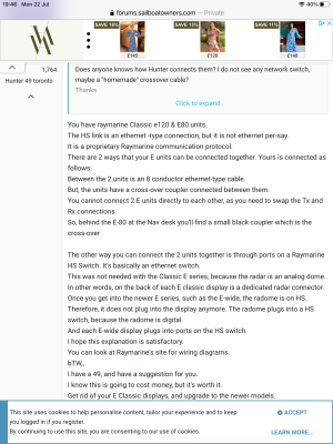

In that case, the connection between the two plotters is Seatalk HS (Ethernet) not Seatalk. I would be worth looking into connecting the autopilot by Seatalk, at some point.
For the current issue, check the Seatalk HS connections and cabling (RJ45 style connectors). You might need a new cable, if so, you can use a standard crossover cable as long as it's in the dry.

The reason you don't get asked about the "Master" is the same reason that you don't get GPS, the two plotters are not networked (they used to be), hence the need to check the network cable. A factory reset is very unlikely to do any good.

Hi guys just an update , I have replaced the Ethernet cable and it’s still not either seeing the second plotter or not sending info to the second plotter , any ideas welcome cheers SS
