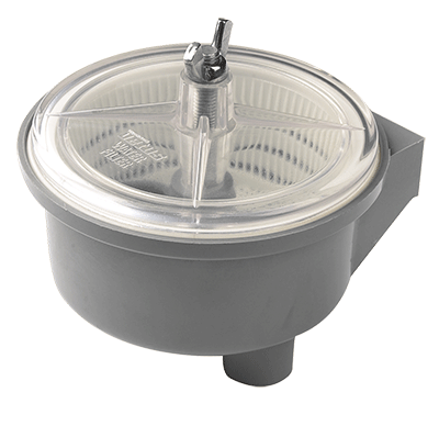

I'd go for the Osculati type (or similar model by Vetus, etc). One advantage of this type is that if you have a problem getting the raw water pump to prime, you can fill the strainer body with water to start it off.

The one issue with the smaller Osculati and Vetus type strainers is the screw on lid tends to jam on if not lubricated, the seal in place correctly and not too tight.

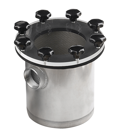

I have strainers with studs and wingnuts or finger nuts to clamp down the lid. Mine are flat perspex and so easy to replace if they get broken and cannot become too tight to undo a you can take a spanner to the wing nuts if necessary. Before anyone comments use an adjustable across the wings of the nuts or waterpump pliers across the finger nuts
Vetus Raw Water Strainer 525 Stainless Steel G1&#189" (Vetus FTR525)

You're right, all the plastic strainer lids can get a bit stuck if they're not greased (silicone grease works best). But there are countless thousands of them giving sterling service. And they don't cost £600!

Our Volvo (the black plastic cauldron type) just corroded through on the brass fittings (metal = bad), so I went for an all plastic Vetus one with transparent lid. First thing I did was apply silicone grease to the o-ring and lid threads and I expect this will work just fine, as it did on the Volvo cauldron. The plastic never was an issue, it's the metal bits that failed.
That cost me €103 including two-day delivery to a Greek chandlery. Wouldn't want to pay more for corroding metal bits. Also I now have a nice transparent plastic lid so I can see there's water flowing and when it's time to let the baby crabs out of the pot ?

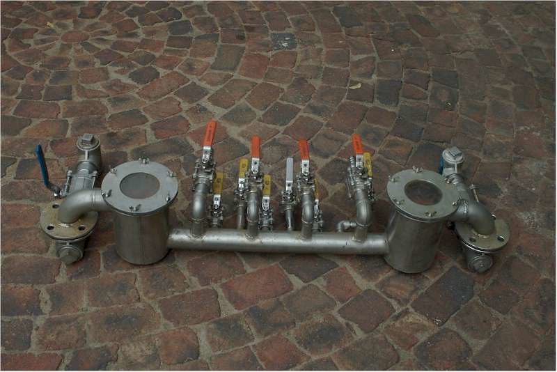

This is my inlet seacock, strainer and distribution manifold.
Some my say its over kill and they could be right but its how I wanted it done as it gives me lot as of flexibility as I can isolate each raw water supplies. I can also change over inlet strainers if one gets blocked. I cannot clean out the strainer while in use but that's not an issue for me as its on a sailing boat.
