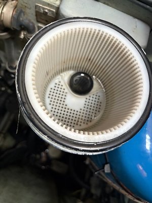

Raw water strainer filling with air

The engine temperature remains rock steady at 80C even when the level is at the bottom of the basket (it goes no lower).
I’m just slightly anxious because one would normally expect the strainer to be full of water. Discussions on other forums have suggest that sucking air could shorten the life of the impeller.
I don’t see how it can be a leak given that when I introduce a leak it expels the air. Also I don’t see why a leak would be there when under way (sailing) but not when anchored/berthed.

The skin fitting is about as low as it could go, just above the hull/keel intersection.
It stabilises when the water gets down to the top of the intake pipe, bottom of the basket. This can take 1.5 to 3 or more hours, more or less in proportion to sea state so I’m sure you are correct about it being an accumulation of bubbles streaming under the hull.
I do wonder whether a scoop style intake fitting would be better.
