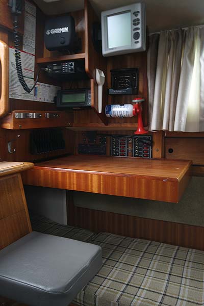

I've seen a few ideas for chart tables that slide into the quarter berth, like this:
The table slides back into the berth like a drawer. Obviously, this will reduce the height of the berth, and make access to the berth more difficult (a shallower slot to slide oneself into). Thus, it's unlikely it would ever be used as a berth - so why not bite the bullet and simply redesign it as an efficient storage space, instead?

I think the photo was from another vessel to illustrate proposal. I don't disagree with sentiments though on Westerly quarterberths and recall they attracted condensation ? However replacement of the cushions if not already completed would certainly be advisable if not a priority in absence of memory foam toppers.
