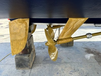

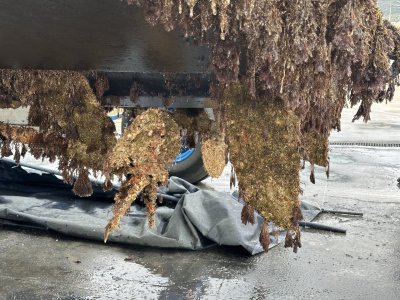

Having used most products over the years, I have just a few days ago had Propspeed applied, not expecting it to last, we shall see!
We get heavy fouling in Sant Carles, 6m since last lift and pressure wash! before and after:
View attachment 177266View attachment 177267
I’m more worried that my before and after will look more like your after and before 😱
