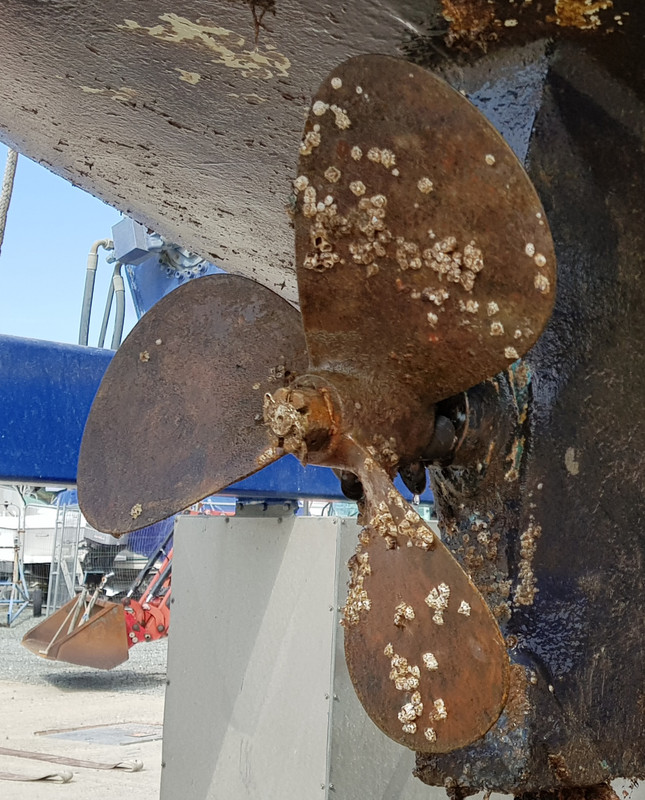

I am using Trilux on my propeller but it does not work very well. Loads of barnacles. Would adding grease on top of Trilux work better.

About 2 seasons ago I bit the bullet and tried Velox. It's a) not cheap and b) a PITA to put on but it seems to stay on and works as an antifoul. One small can of primer and same of velox itself was around £45 but has now done 3 seasons and should do a fourth. And I have zip connection with the firm that makes it.

Based upon recommendations from the forum I now first paint my prop with Hammerite Special Metals Primer, then Primocon and finally Trilux 33.
The antifoul lasts better than without using Hammerite but still washes off.
An additional benefit is that the Hammerite really sticks so anode wear is less due to it reducing those pesky electrons running amok

I also use Hammerite Special Metals Primer, sticks really well to a well keyed prop. I use hard antifoul on top of the primer. I found that a very gentle sand of the primer, once it has had a couple of days to go really hard, makes the antifoul bond much better. By the end of the season most of the antifoul is gone but he primer is still there and is clean, I don’t think nasty marine stuff likeS the primer.

You are correct about the longevity of Hammerite Special Metals primer. I first used it in 2012, two coats followed by four coats of Velox (the advice at the time). At the end of that season the fouling was controlled but the Velox had chipped quite badly.
Subsequently I abraded the Hammerite lightly and only applied two coats of Velox, which reduced the amount of chipping. I have used this approach on every season since but amazingly, the same original application of primer is the only one there, I simply rub down and add Velox at the beginning of each season. Here it is again at the end of 2018. By this stage I had also given the P-bracket the same treatment. Both photos before pressure washing

The yellow paint was probably Propspeed, developed a fair while ago by a bunch of Kiwi's. Here's Hinewai's prop last year just before relaunch.
I've been using it for many years and it works great, has kept my stainless steel prop clean from Melbourne to Dover, and for more than 9 months a time.
A bit fiddly to apply being two coats that need to be applied pretty nippily, the yellow being the base etch primer overcoated with some clear stuff.
They say it should only be applied by specially trained professionals but follow the instructions and it's not hard to get a good job.
OK, it's not cheap but you'll get several applications from the tins. So several years worth.

That's interesting. I did mine several years ago, wrote it up in PBO, published last year. Due to illness and other problems the boat was in the water for two years and four months without moving. Prior to that the boat was in a drying berth for six months, prop not cleaned after that. At haul out the prop was remakably clean, just a few barnacles. The hull was heavily fouled with mussels (scraped off in the pic).
