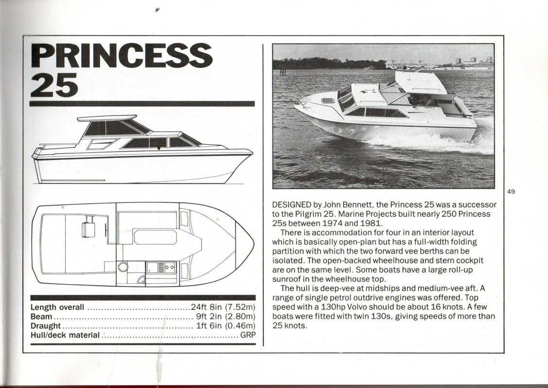

But here is the difficulty you might be facing. Am I right in thinking that the Perkins engines may not be original to the boat ? They could be..but if they aren’t and your boat originally came with twin VP 4 cylinder petrol engines originally…as they usually did..then I’m afraid that it’s often the case that when this is done (transplant from petrol to diesel)..there is often no consideration at all towards the outdrive gear ratio and or prop set up. As in, someone throws a pair of diesels in to replace a pair of Petrols, not thinking about the obvious rpm and power delivery output difference between the two. The Petrol engine will deliver its power at a much higher rpm that the diesels. Usually perhaps around 4000-5000 rpm or around there. The diesels at a general assumption, will be around 3000 give or take either way. An original set up would have the gear ratio and or props specified and pitched to suit. If the transplant has not dealt with this requirement, you may well find that even if you did know what props you originally had..they could have been wrongly suited anyway.
Probably not what you want to hear..but a true and common story. Of course..feel free to ignore all this, should the lovely P25 have been fitted with these Perkins from new. Not something I’m aware of though..not to say it’s not a possibility all the same.

Thanks for a great reply, you are spot on she came originally with VP petrols so think you called it spot on. Will try the FB classic page but just want to get her back to her new home berth and try and get some trips in weather playing ball.
