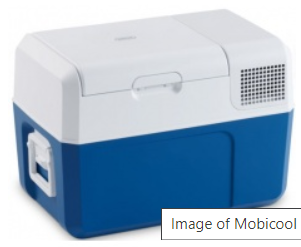

Another Dometic owned brand is Mobicool. Available from several dealers, some within your budget.
Mobicool MCF40 12 Volt - Mains Portable Compressor Fridge or Freezer
Ours works perfectly, been on many travels in a car (hotel rooms) or boat. Nice with digital temp setting, internal light etc. Adjustable, built-in battery protection too. Very low noise.
