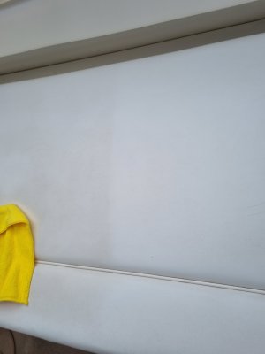

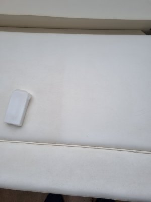

Dino thanks for the link to Drakes Detailing. I watched their video on cleaning vinyl seats and had a go over the weekend. Looking at them I didn't think mine were that dirty but boy was I surprised. Instead of Purple Power I used his other suggestion of Simple Green. Having spoken to the retailer he recommended to use the Simple Green Crystal. Used a 1:10 ratio and the results were brilliant. Followed by the 303 aerospace to seal and protect.
