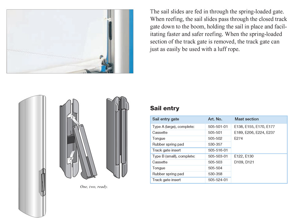

Edit: All I see in your image is a black hole in the mast, but on looking again is there a fitment in it? If so, ignore the following:
Is there a bit missing from your mast? My Sadler 25 Kemp mast has a similar oblong "cutout" a couple of feet above the gooseneck. However, it has one of the "feeders" shown here:
http://www.getrigged.co.uk/sail-entry-gates-104-c.asp
The mainsail has sliders, and you simply insert them via the feeder, and they are then "trapped" in the groove until you want to remove them. Difficult to explain, but easy in practice. Here's another image copied from the Selden website.
