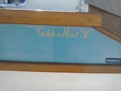

How bad is it? I have just refurbed lots of teak on my 1979 boat, although it was varnished or stained - most flaking off. Old teak can come up well with a bit of patience and then my choice of finish is Woodskin.
It’s kaput. I’m seventy and for forty of those years I owned teak planked sailing yachts. Bought this one five years ago. My first plastic boat. The cappings had been scrubbed till the bungs started to pop out, then neglected.

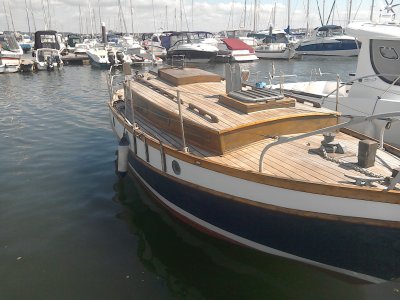

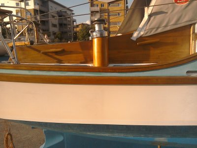

OK good luck with finding Iroko in long enough lengths and suitable for the sort of curves you need for rail cappings. I did this one in mahogany from 3.6m 30mm wide, 20mm thick in 1992, teak deck in 2014. Photos in 2019
