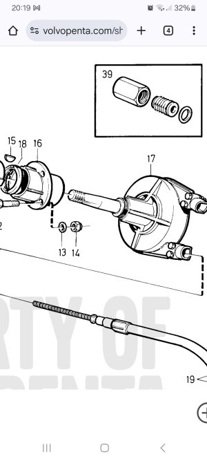

We have some play in our steering wheel. I have replaced the part marked 17 below. This is made a slight improvement but it hasn't totally fixed the issue. Has anybody got any ideas what I could do to totally fix the problem (boat has DPE drives)?

For clarification, the play is when turning the wheel.
Mine started doing that a few years ago , part 15 the key had been substituted for the shank of an Allen key.
I machined a new part 15 , tightened the steering wheel nut and the problem was solved.
I would start with tightening the steering wheel nut and then checking the key ( 15) and slot the keyway , if the key way has worn it will be easy enough to machine a new thicker key (15)

Thanks. Was is rotational play in the wheel?

Did you replace 19 too? It looks like cable steering IME if the helm unit needs changed the cables are usually worn too.
Yes, you could steer port or starboard and nothing happened for the first bit.
The most likely explanation is the nut needs to be tightened but the wheel has to come off to check nothing is stopping it seat all the way home. It’s a tapper if I recall correctly so it might just need a tweak up.
If that doesn’t work then the keyway might be worn or damaged.
If it has play in it then a new key will at best solve half of it hence machining a new key to your requirements may work best.
I did mine with a hacksaw and bench grinder from a stainless steel kitchen utensil, you don’t need precision engineering qualifications .
