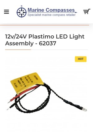

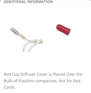

I'm intrigued by everyone jumping straight to red LEDs .. Plastimo for instance recommend LED colour based on compass card colour.
That Plastimo bulb description also suggests not using the red diffuser with red compass cards.
Note: That's only an example. They sell a different LED for pre-2016 year compasses.
