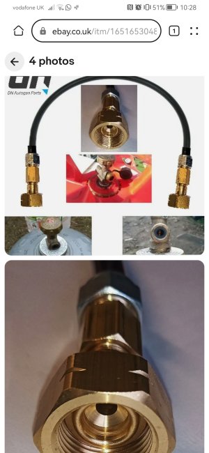

I think weight should be straightforward enough. It takes 4.5kg of gas so will put in 4kg to be on the safe side.
For a 15kg donor bottle you need a 21mm clip on unregulated fitting one end and 21.8mm lh nut other end, empty bottle weight is on the collar in lb oz format, spring balance or scales beats electronic as they time out part way, put Recipient bottle in the freezer first and warm donor bottle to make it lots quicker.

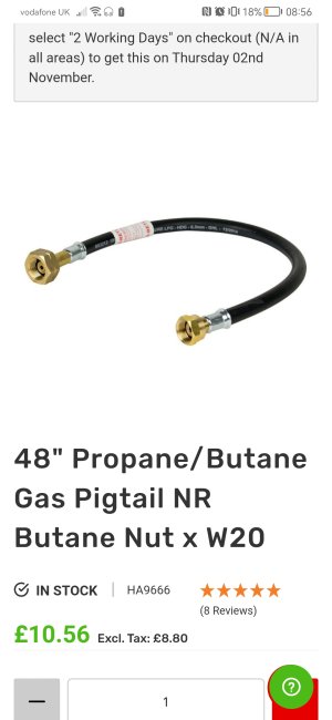

Your donor cylinder will probably have a 21mm push on connection.
You will, therefore, need a push on adapter for that ( eg Gas Boat 4014) or an adapter for what ever fitting your donor cylinder has
Then a hose with a W20 nut at the donor end and a Butane nut at the other** , or with another W20 nut at the other end ( eg GasBoat 4017) followed by a M20 to butane nut adapter (Gas Boat 4012) to fit the Calor 4.5kg cylinder
Other combination are possible
See WHayward Marine Gas Systems | GasBoat | Go anywhere Gas Regulatos for the GasBoat fittings
**The hose you illustrate is correct not what you seem to describe with a POL propane connector.
The fitting for your 4.5kg cylinder is usually described as a "butane nut". It has an odd sized left hand thread.
Please double check all the above numbers etc

Donor bottle and the recipient both have the same fitting. Not sure what you call it. A female threaded standard calor gas one! Thanks
I missed this earlier
The small cylinder will have a male 21.8mm LH thread ( The so called "butane nut" fits this.)
Modern larger Calor butane cylinders have the 21mm push on fitting. If yours has the above thread then the GasBoat 4017 hose and 2x GasBoat 4012 adapters will do the trick, but next time you change your donor cylinder it will have the push on connector if it is a Calor one.
