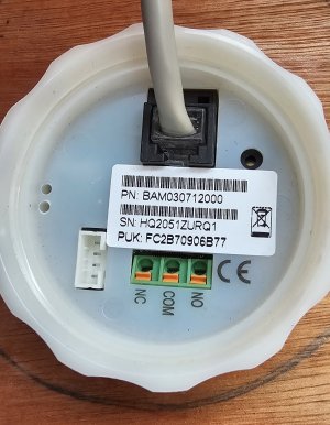

Victron connect can see the BMV, but I can't get it to accept any of the default PIN codes, 0000, 000000, or 1234.
The instructions say look on the label on the back of the device.
Does anyone know how to decode the lable, or an alternative default PIN Code, or a simple way to reset the pin code to siple default?

@Ian_Edwards .... On the device list page of the Victron app there will be an entry for the BMV ... there are 3 dots to the right ... press the three dots corresponding to the BMV and you have the option to reset the PIN code, press this and then enter the PUK from the label (FC2B70906B77). The pin code will be reset to 000000.
