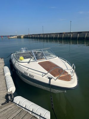

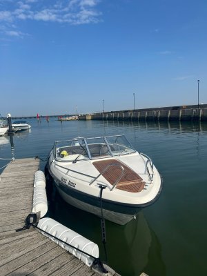

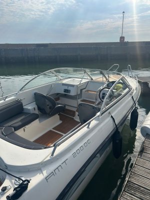

Sea trial planned for Sunday
The boat looks in good condition and particularly the outboard leg.
The boat is afloat half the year and trailer stored in winter. From the sticker on the engine it may have been on the Thames at some point as I bought my bf135 from that dealer.
There are very few good condition outboard cuddys on the market currently and this looks quite modern too.
I did look at a Finnmaster 6100 last week but it had no service history for a 13 year period, not even a receipt for an oil filter...
Mrs HP liked the boat layout but agreed we'd wait until a better condition one comes to market.
Until, that is, we found the AMT......

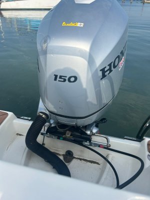

On the starboard side of the engine is a flushing hose and weird connector. This doesn't seem to fit securely in the engine casing. Lots of comments on line but in practical terms it's odd but doesn't matter. I always give the engine a 5 minute flush after use swapping the end termination for a flushing adaptor. Easy with the engine fully tilted and wheel over to port. No need to run the engine.

Thanks for the tip
I had a bf135 and it sounds like the same arrangement.
Collection on Wednesday, back to base and quick oil, filter and impeller change.

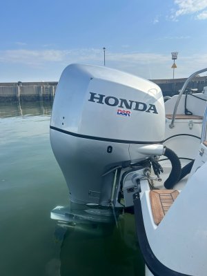

I think the engine is mounted too low, lots of drang from the leg.
I'll check and if not correct, I'll raise ventilation plate about 1.5 inches above keel line.
It certainly didn't feel like a 40 knot boat on the sea trial but fouled hull, engine low and bimini up will all be factors...
Few photos attached.

Before you raise the outboard....check how she handles in port....without anyone sitting in the back....a boat like that might be rated upto say 200 hp.....so manœuvres well with a lot of weight in the back....a light outboard might not grip as well unless people sit in the back or the leg is low. Of course I know nothing about your particular boat...but I have been in this situation before

Handling is OK but performance on the sea trial indicates that the engine is too low - the photo shows the saddle hard on the transom top.
When the engine was rigged I suspect the company doing it went for safety and kept the vent plate well below the keel line. They don't want customers coming back saying it ventilates in a turn. I had a Fletcher 19 sportscruiser and the engine was removed to clean the carbs. They put the engine back on 1 hole lower. It took 4 knots off the top speed in same flat conditions.
As the engine hit 6k revs at WOT I suspect the boat is under propped. Raise the engine, revs will rise, fit new bigger pitch prop, engine revs back down to 6k = faster boat!!
