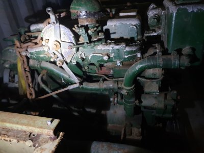

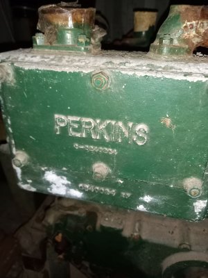

arfabuck
23 Mar 2025
2
Thanks for the reply Roger.
It is a 4 cylinder, green painted motor.
Has a Borg Warner gearbox.
perkins side.jpg Sorry pics are not the best. It is dark down there and took pics by flashlight.

If I remember rightly - the old Perkins had the serial number / model number down on the block near either the water pump or the injection pump.
The number when given to Perkins tells whether its a standing industrial engine (my 4-107 is one) or a modified vehicle engine or a marine unit.

While that is useful for more recent engines, the one the OP has is a much earlier P4 (also made as a P3 and P6) Mainly used in Massey Ferguson tractors. The P3 was also fitted to Trojan vans. A mate had one in the early 60s. 30mph just about achievable and very exciting. trojanmuseumtrust.org/gallery/postwarvans/
