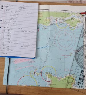

Despite the curvy line in my crossing last year, there are less sea miles if you set a course to steer (heading) in the autopilot rather than a GOTO waypoint. In my case, worked up a CTS of 010 degrees from Alderney to the Fairway buoy and stuck that in the autohelm and just trimmed sails as we went along.
Even with a couple of hours to go to Fairway, the projected straight track line on the plotter screen was planted straight over St Cats and the IOW, it's only when the ebb really kicked in did the magic happen. See my scribbled workings, there is a 2.3kt then 4kt westerly flow only right at the end, the track history shows it grabbing us and pushing back across towards Fairway.
If I'd punched in a GOTO waypoint, the COG would have matched the line on the chart and we would have travelled a few more sea miles to achieve this, thus less efficient.
Since the general course had some east in it, I chose the passage time to make best use of all the flood since it would carry us generally in the right direction.

He didn't say to aim for a waypoint. He means set the Autohelm to a magnetic bearing and then recalculate the final leg in 12 hours or so when the opposing tides have roughly balanced each other out.
Lovely to see these recovered posts- we diligently do our calculations having read in fear accounts of being set past the entrance towards the CapDH but in reality I guess it might turn on if passage is neaps or not as we notice little variance although that might be down to accuracy of predicting position at a given journey time. Anyway always interesting to see others calculation methods so thanks for sharing picture
